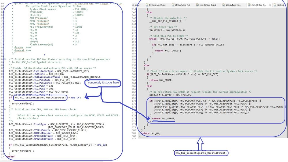

In which I said that I will make some hardware modications in order to achieve the technical suggestions and manufacturer instructions. First it was thought that two missing capacitors were causing miss function on internal regulator. So I added them in a new printed circuit prototype.
I have made these changes, but problems still being the same:
I really need to be able to run some kind of firmware. I'm spending a lot of time with this trouble.

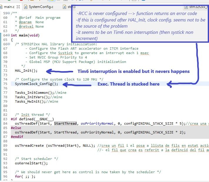

Why is the interruption unable to be triggered when:
Please if some one could help me with the next steps to find what is the cause I will add the information that could help him to understand my application and its configuration.
-I'm using FREERTOS,
-I changed HAL_TICK base timer by TIM6
-I'm using TCP/IP middleware
-BOOT0 = GND
-VCAP1 = VCAP2 = 1.189V
These 3 things are working fine on NUCLEO board, but there I'm using ST-Link with serial wire from PC. I'm using stmcubeIDE debugging interface. I don't really know if there is a great difference with my custom board in order to make interruptions not be happening. The final circuit desing is very simple:

When I try to program or debug with segger from stm32CubeIde debug/run interface, mcu seems to be frozen or even hanging up. But after this moment, if I power off and I turn on my PCB, I can see how some outputs are just blinking as my firmware did on Nucleo board.
It is a very weird situation because of two factors:
I can't trust enough the segger device + CubeIde combination.

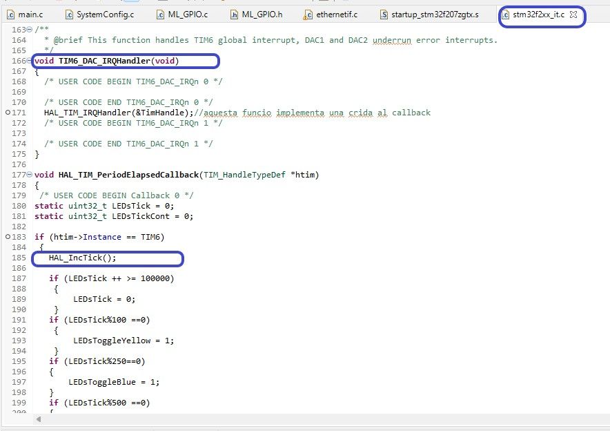

Should be able to run without any debugger attached.
Instrument Hard Fault and Error Handler so you know if things when to die there.
Make sure the IRQ Handler for TIM6 is present.
Unpack NVIC, RCC and TIM6 peripheral register in debugger, or dump to terminal.
Does SysTick or other interrupts work?
Do things work independently, ie you don't call HAL_Init(), but simply bring up the peripheral(s)
Should just continue running at HSI 16 MHz
Does PLL start? What setting for that an VCO?
What specifically hangs up in HAL_Init() ?
