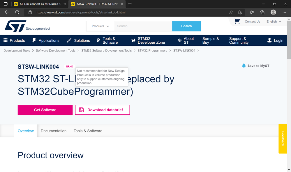

ST-LINK UTILITY does not support G491.
Please try to use STM32CubeProgrammer.
https://www.st.com/en/development-tools/stm32cubeprog.html

Ups, this is surprise to me.
So there is a real severe difference between STM32G474 SW-Debug-Interface and STM32G491 SW-Debug-Interface? (I always use the two wire debug lines SWDIO and SWDCLK together with NRST-Line, so together with GND it is a small 4 pin connector).
Is it possible to use Keil uVision Debugger with STM32G491 (SWDIO/SWDCLK), or should I expect here similar problems as with ST-LINK? (As Interface to Keil uVision, I use such a Nucleo ST-LINK interface...).
What a surprise, you are right ... CubeProgrammer works nicely, and also Keil uVision.
Thanks a lot, this made my day... .
