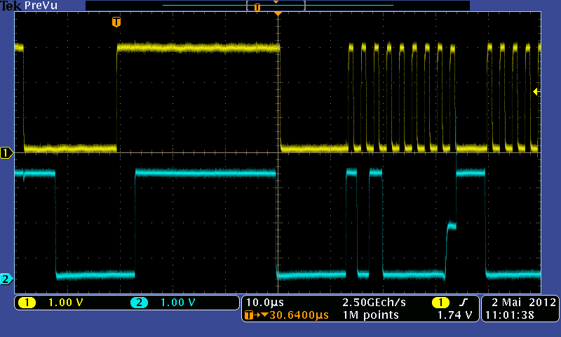

I share a screen of a result of my code in my oscilloscope.
Ther is an strange thing between my start and a adress send, i don't know why i have this attent time, and an other strange thing, it's my ACK it's not 0 but not 1 it's between the both. I've testes for twot EEPROME ( the m24lr64 and m64c64) the result are the same.
Anyone can help me, or have this same problem.

try configuring the pins in open drain mode
Posted on May 04, 2012 at 15:22
thank you ver much that was the mistake in my code.
