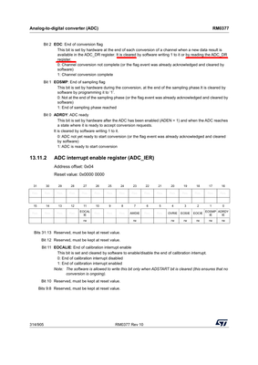

In this particular case, the debugger is probably displaying also ADC_DR, and reading ADC_DR (regardless of whether by processor or debugger) clears ADC_ISR.EOC.

This is just something I would never have thought of. It would explain the anomaly!
