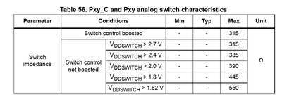

So on lqfp144 its not PC3, but PC3_C .
So you are on an analog mux connected pin, about 400 ohms internal resistance.
You cannot change this ... for hi speed, use another pin. NOT an crazy analog connected.
(I didnt make this design - so dont blame me. I got similar experience , so i know . )

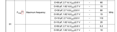

Have you tried changing the maximum output speed setting of the pins you use for SPI?

Signal looks like : too much capacitive load or speed to low (setting!).
So set probe at 10:1 and port speed medium (or hi, depends on your SPI clk speed).
Always set speed to lowest possible (to avoid excessive ringing), but high enough for the desired speed.
see ds for possible/useful speed settings.
