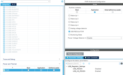

2025-02-27 11:29 AM
Hi @halfordC
It seems we missed to add this "hidden" tricky checkbox in IOC file,
