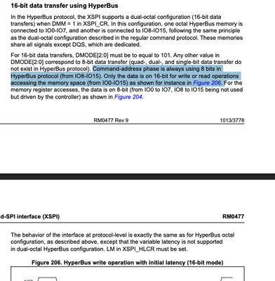

1. Variable latency is not supported (LM bit in XSPI_HLCR must be set)
2. Register space access uses only IO[7:0]. Quote from RM0477:
"IO8 to IO15 being not used but driven by the controller"
So I can only access registers of chip #0.

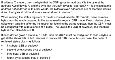

However, I'm confused about the data layout when reading registers in DMM.
My understanding (based on your explanation):
In 16-bit dual mode, both chips receive the same command simultaneously. Each chip drives its own byte lane:
Since both chips are identical, IR0 on both should be the same value, for example 0xB1B2. So I would expect the controller to assemble two 16-bit words as:
Word 0: IO[15:8]=B1 (Chip#1), IO[7:0]=B1 (Chip#0) → 0xB1B1Word 1: IO[15:8]=B2 (Chip#1), IO[7:0]=B2 (Chip#0) → 0xB2B2
Expected buffer (4 bytes): B1 B1 B2 B2
What I actually receive: B1 B2 B1 B2
This looks like data from a single chip repeated twice, not interleaved data from two chips.

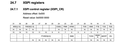

Bit 6 DMM: Dual-memory configuration This bit activates the dual-memory configuration, where two external devices are used simultaneously to double the throughput and the capacity. 0: Dual-memory configuration disabled 1: Dual-memory configuration enabled Note: This bit can be modified only when BUSY = 0.
Thank you for the document. After reading it carefully, I now understand the byte order (B1 B1 B2 B2) correctly.

What I found in RM0477:
"Command-address phase is always using 8 bits in HyperBus protocol (from IO0-IO7). Only the data is on 16-bit for write or read operations accessing the memory space (from IO0-IO15)."
"For memory register accesses, the data is on 8-bit (from IO0 to IO7, IO8 to IO15 being not used but driven by the controller)."
This suggests that in 16-bit dual-memory HyperBus mode, register space access only works through IO0-IO7 (Chip1), and Chip2 (IO8-IO15) is completely ignored during register access.
Question: Is it possible to configure CR0 registers of both chips in dual-memory mode? If so, how? Do I need to temporarily switch to single 8-bit mode with separate CS# for each chip to initialize the registers?
