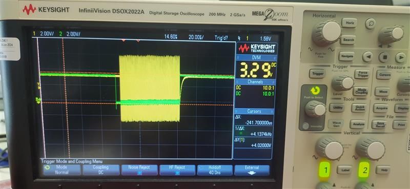

I am trying to establish a successful transfer using SPI in master full duplex DMA mode using a NUCLEO-H7S3L8 board (STM32H7RSxx family)..
The runs and SPI data can be seen from the MOSI pins, but with one problem: data is not successfully sent.
In the following photo:
504B @50MHz are being transmitted (CH1 trace - yellow one - is SCK, CH2 trace is CS):
total time of transmission is:
20us * 3.1 = 62us
vs
(504*8/50e6) = 80.64us
which is the time required for such a full transmission, meaning that approx. 116 B (according to these numbers) are missing on transmission.
However, when I read the GPDMA_CxBR1.BNDT[15:0] (previously programmed to 504) after GPDMA TC Irq, its value is 0, meaning that all the 504 should have been transmitted... But that's not true according to oscilloscope analysis.
So ... what is the missing piece? Maybe an LLI setup?

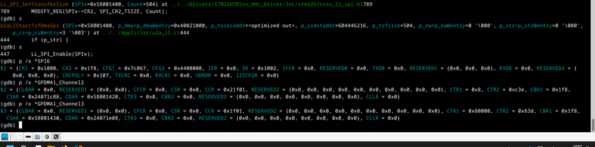

2025-06-13 1:02 AM - edited 2025-06-13 2:53 AM
@TDK wrote:I believe it's actually 80.64 us.
Yes, this was obviously a typo. Fixed. Thanks.
The following is just before starting the transfer:
There is a strange p_txsrcaddr=<optimized out> that it might could be part of the issue....
s.
PS: the issue happens also with lower GPDMA_CxBR1.BNDT[15:0] values (e.g. 256 instead of 504).
2025-06-13 6:37 AM
Looks correct as far as I can see.
How do you know not all data is getting sent? Just based off of the width of the transfer? Is the measured bus speed 50 MHz? Does it work with 2 bytes? 1 byte? Lower clock speed?
When is U2aLlStopTrfSpiDma called? Need to wait for transmission to end, not just DMA completion.
2025-06-13 7:00 AM - edited 2025-06-13 7:09 AM
@TDK wrote:How do you know not all data is getting sent? Just based off of the width of the transfer? Is the measured bus speed 50 MHz?
The clock frequency is 50 MHz measured on oscilloscope and yes, based on the width of the transfer, not all data is sent, simply math. I don't understand how could 504B could be transmitted in less than 80.64us at 50MHz.
I have tried with 256B and the same happens. I have to sit a while and try with far lower transfer sizes and lower clock speeds but I do not expect lot of better results.
16 bits of BNDT should allow enough size transfer unless otherwise stated..
I also noticed that setting SPI's duplex to half as transmitter, the time width of the transfer is the half of a full duplex like in the oscilloscope capture. In this specific test it was 256B. This is a non sense right now.

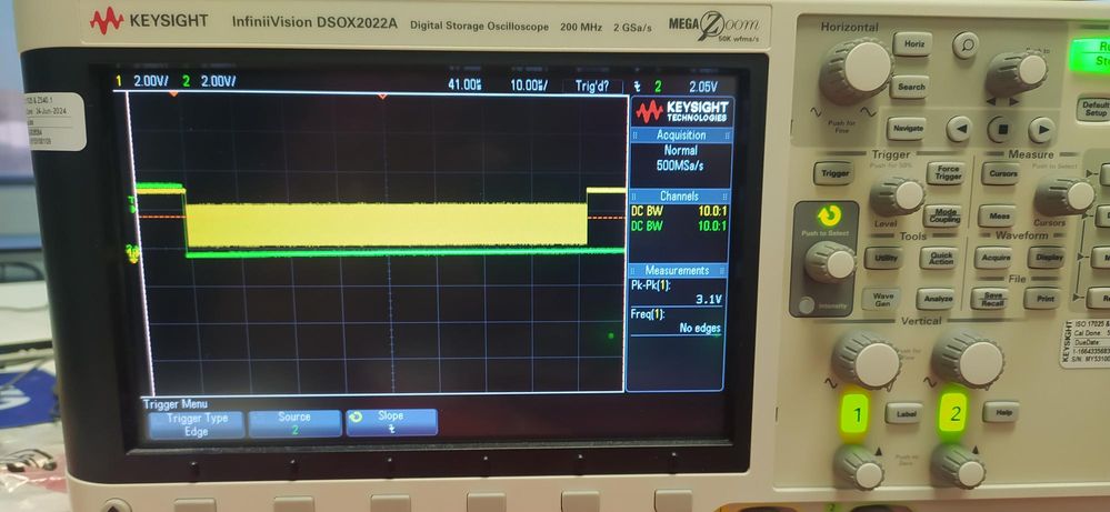

2025-06-16 3:27 AM - edited 2025-06-16 2:55 PM
So, I tried to simply do not stopping the DMA channels in its IRQ of Transfer complete leaving this job for SPI, and these are the results:
