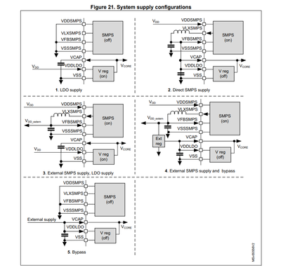

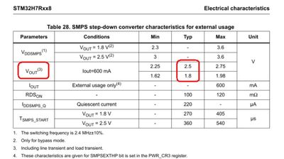

Can anybody explain how it is possible to power VCORE directly from SMPS output?
I see that SMPS have only two possible output voltages, 1.8V and 2.5V:
But VCORE accepts absolute maximum of 1.4V.
So how it is possible with LDO bypassed?
Best Regards

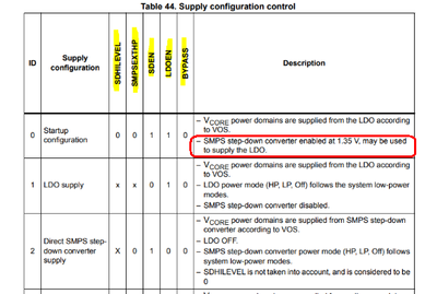

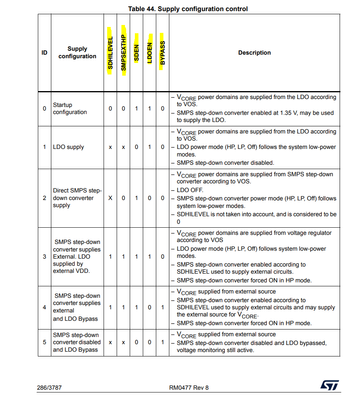

Depending on the mode you wish to work in,
you need to properly set the bits (SDHILEVEL, SMPSEXTHP, SDEN, LDOEN, BYPASS) found in Table 44. Supply Configuration Control in the Reference Manual RM0477
For the SDHILEVEL bit, which controls whether the SMPS outputs 1.8V or 1.2V
Thank you.

So there are two additional information, important for me:
1. SMPS may have different voltage than 1.8 / 2.5 V.
2. There are another power mode, not indicated in schematic: SMPS on, VCORE powered from SMPS but with LDO on.
Thanks for this.
Best regards.

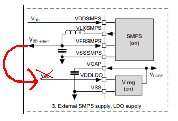

I mean the situation when VCORE is powered from SMPS thru LDO.
This mode is not listed here:
But it was mentioned here:
The closest mode is mode 3, when we externally make this connection:
But for some reason, You didn't include this mode in the documentation.

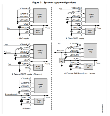

2025-05-14 7:03 AM
For this mode in the STM32H7RS, it's not supported. Therefore, the phrase mentioned in Table 44: "SMPS step-down converter enabled at 1.35 V, may be used to supply the LDO" will be updated in the next release.

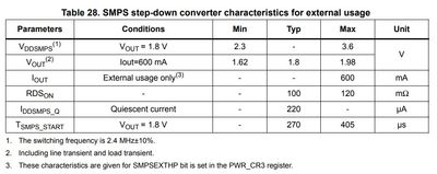

Note: You need to update your datasheet document because I noticed there is a difference between Table 28 SMPS step-down converter characteristics for external usage which exists on the website and your version.
Your screenshot:
Which exists on the website:
Thank you.
