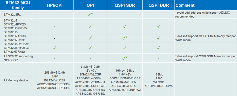

which memory PN are you looking for ?
Let me just remind that STM32H7B0 supports OPI (APS6408L)... and QSPI DDR (APS12808O-DQ) full spec but have a memory mapped write limitation for QSPI SDR (APS6404L...)
Thanks
Alex
PS: Overview of IoT RAM (QSPI, OPI & HPI PSRAM) support
| STM32 MCU family | HPI/OPI | OPI | QSPI SDR | QSPI DDR | Comment |
| STM32L4Rx | - | ✓* | - | - | *avoid odd address write issue - ADMUX recommended |
| STM32L5 STM32L4P5/Q5 STM32U575/585 STM32H5 | - | ✓ | ✓ | ✓ | |
| STM32H7A3/B3 STM32H72x/3x | - | ✓ | ✓* | ✓ | * doesn't support QSPI SDR Memory mapped Write mode |
| STM32U59x/U5Ax, STM32U5Fx/U5Gx STM32H7Rx/Sx | ✓ | ✓ | ✓ | ✓ | |
| All STM32 supporting NOR QSPI | - | - | ✓* | - | * doesn't support QSPI SDR Memory mapped Write mode |
| APMemory device | 256Mb~512Mb 1.8V BGA24/WLCSP APS256XXN-OBR/OB9-... APS512XXN-OBR/OB9-... | 64Mb~512Mb 1.8V ~3V BGA24/WLCSP APS6408L-xOBM-... APS12808L-xOBM-BA APS12808O-OBR-WB APS25608N-OBR-BD APS51208N-OBR-BD | 16Mb~128Mb 1.8V ~3V SOP8/USON8/WLCSP APS1604M-xSQR-… APS6404L-xSQR-... APS12808O-SQRH-WA | 128Mb 1.8V WLCSP APS12808O-DQ-WA |

STM32H7B0 won't support QSPI SDR (SOP8) memory mapped write, but fyi all following will : STM32L5, STM32L4P5/Q5, STM32U575/585, STM32H5, STM32U59x/U5Ax, STM32U5Fx/U5Gx
STM32H7Rx/Sx
