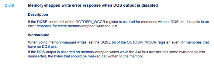

Hello @Ayoub Cheggari ,
There is an errata "Memory-mapped write error response when DQS output is disabled". So with this errata we need to enable the DQS when doing memory mapped writes even if the memory do not support DQS. This is the workaround as you did.
Now concerning products with AXI bus (OCTOSPI memory mapped region on AXI not AHB) the memory mapped write are always done in multiple of the AXI bus size (64-bit).
So when you do a 8-16-32 bit write , the OCTOSPI will output 64-bit and mask the rest using DQS pin. The problem is if the memory do not support DQS (which is in our case), the rest of the AXI data will be written to the memory. so if you write : *(__IO uint8_t *)0x90000000 = 0xFF, 0x90000000 will be written correctly but the data from address 0x90000001-0x90000007 will be corrupted. This is why we need to make access in 64-bit.
This is described here in the errata sheet : "If the DQS output is asserted on memory-mapped writes while the AXI bus transfer has some byte-enable bits deasserted, the bytes that should be masked get written to the memory."
