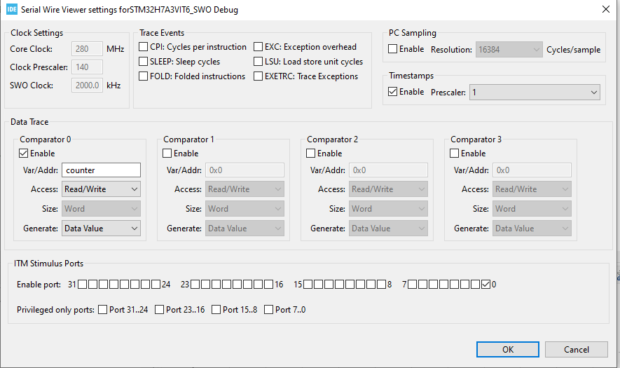

}My debug configuration looks like this:
And my SWV ITM configuration looks like this:
Please help me figure out how to get it up and running, because I'm getting frustrated after all my failures in tutorials.

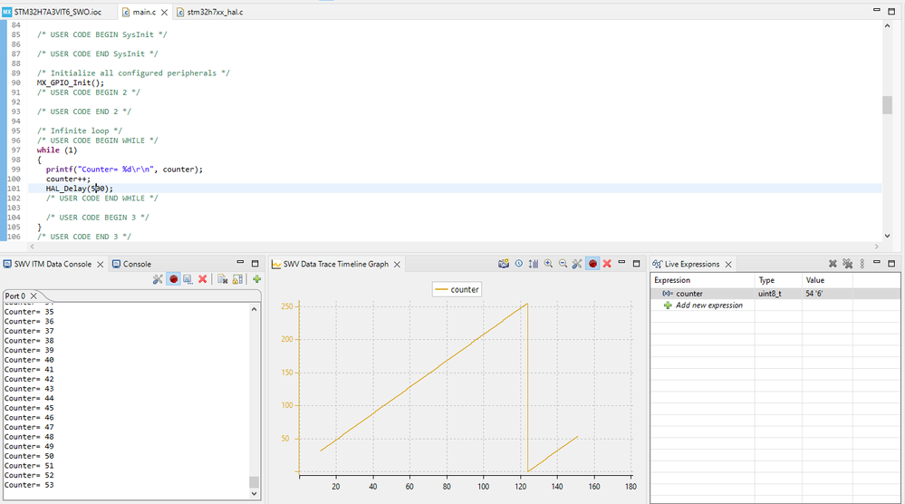

Hello @ypiotrp (Community Member)
I successfully tested printf stdio redirected to ITM SWO on STM32H7A3VIT on custom board with STLinkV2-1 standalone and STM32CubeIDE v1.11.0 (but it also works with v1.9.0)
Here a screenshot of SWV ITM Data Console, SWV Data Trace Timeline Graph and Live Expression:

/* USER CODE END 3 */In the debug configuration, enable SWV with the same CPU clock (280MHz)
Launch the debugger, open SWV ITM Data Console, enable ITM Stimulus Ports 0 (optionally set counter variable in data trace comparator)
Start Trace (red button icon) and resume debugger.

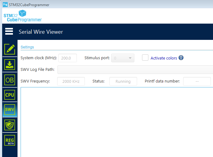

2023-01-31 4:28 AM
putty :)
you need a "debug" connection; new version of Cube programmer should work...(i didnt test)
