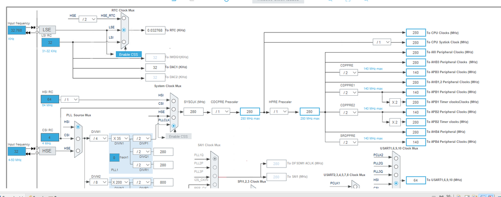

I run the MCU on 280 Mhz:

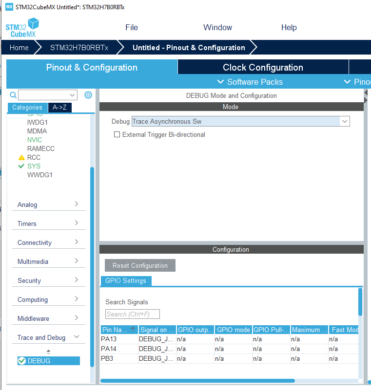

In Pinout & Configuration -> DEBUG I configured Serial Wire as debug interface.

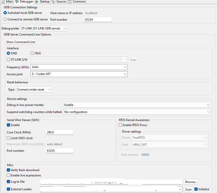

}My debug configuration looks like this:

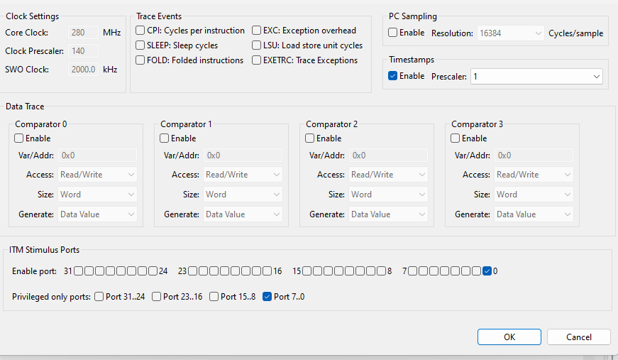

And my SWV ITM configuration looks like this:

"In Pinout & Configuration -> DEBUG I configured Serial Wire as debug interface."
You must set Trace Asynchronous SWO with PB3 as JTDO-SWO.

Hi Romain,
I tired also this option but the result was the same - empty SWV ITM Data Console. Have you got any other idea?

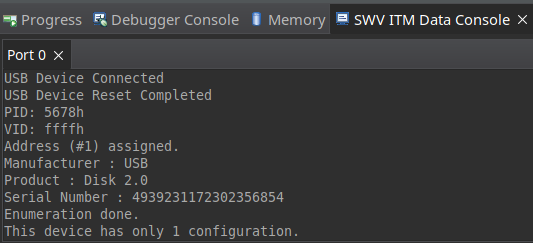

2023-01-25 10:47 AM
this is, what comes from USB host , with debug on:
+ i didnt click red button or anything, still setup is running like i set it 3 days ago , on last debug of this project.
