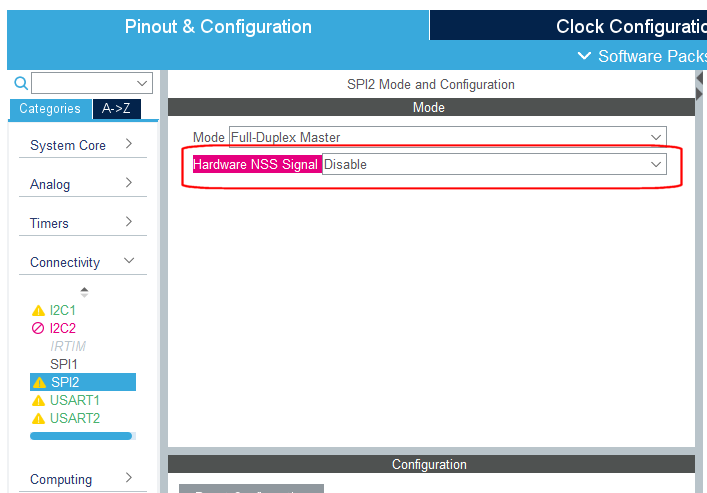

In your .ioc file (CubeMX project) disable the Hardware NSS:
