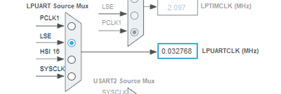

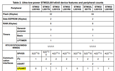

Based on your product Datasheet, yes, a 32.768 kHz clock (LSE) is needed to allow LPUART communication up to 9600baud. Therefore, even in Stop mode, the LPUART can wait for an incoming frame while having an extremely low energy consumption.
except if you have the STM32L051K6, it does not support LPUART
to configure it, just enable your LSE in your RCC configuration
enable your LPUART
and select LSE as input for LPUART in clock configuration
this article maybe helpful for you also
Hope that answered your question, if yes please mark it as solution to close this thread
Gyessine
