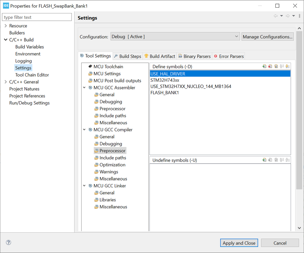

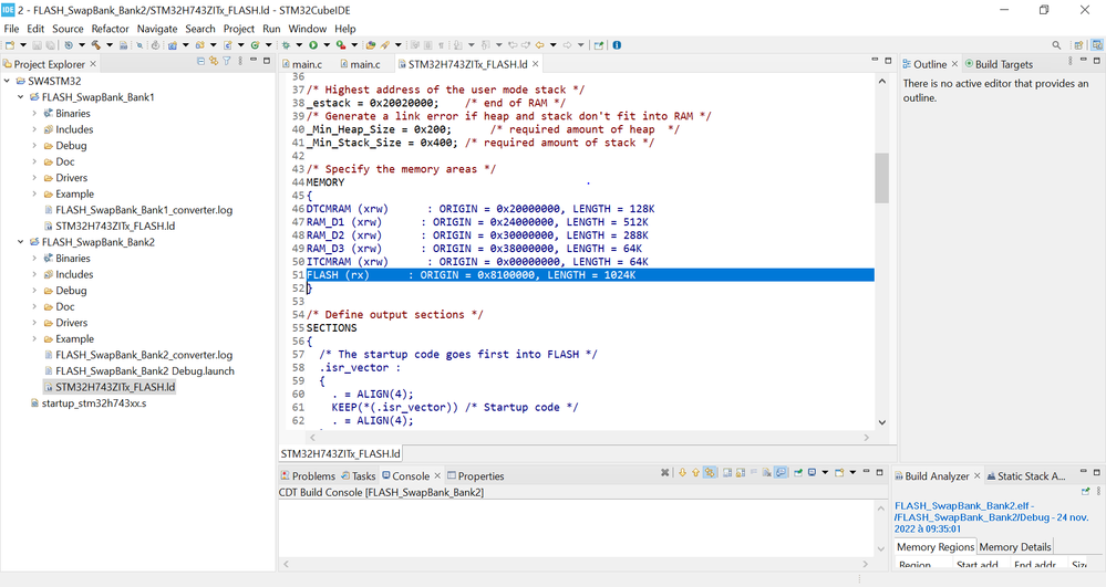

Hello @avulas76 ,
Could you please verify the configuration in your project flash bank 1? and make sure in the other flash Bank 2 there is no FLASH_BANK1
Also verify, the vector table in Flash Bank 2 project should map to 0x0810 0000
and check the linker file is correctly set
2022-11-28 7:32 AM
Thank you for the information, @F.Belaid.
I do see the same settings and re-tested the code several times by changing the swapping.
#ifdef FLASH_BANK2 to #ifdef FLASH_BANK1 in main.c file and confirmed the LED functionality working. But the swap functionality NOT works.
Attached are both the BANK1 and BANK2 source codes for your review.
