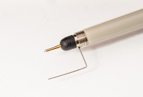

‎2023-05-11 9:26 AM - edited ‎2023-11-20 5:41 AM
like this...
https://electronics.stackexchange.com/questions/491355/oscilloscope-probe-points

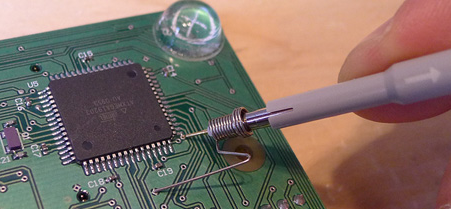

like this...
‎2023-05-11 10:44 PM
Oh boy, I didn't even expect someone to NOT use 10:1...
The GND probe point you see above should be available with each high speed probe / scope, if not, grab some silver wire and roll your own. :D
