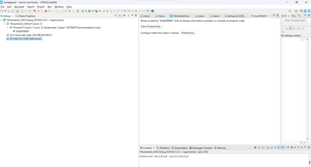

2023-04-17 4:24 AM - edited 2023-11-20 9:18 AM
i am getting same issue ,how i can solve this ,in stm32745zi
2023-04-17 4:34 AM
Perhaps hardware issue? Details and specifics not shared.
Perhaps look at suggestions in this thread and solution. Does it apply to your situation? Did you look at any of suggestions for cause in your case?
2023-05-12 9:53 AM
I was getting the same error using the STM32H747XI_discovery board with the sample LED light tutorial. Setting up the debug configuration exactly as they did in the videos. The one item that I did change to get it to work was to not download the symbols for the CM4 inside the CM7 debug configuration. Then allow the CM4 debug configuration to download the symbols when launching its debug configuration. Hope that might help someone.
