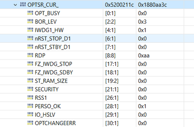

Digging a bit more, I can see the FLASH OPTSR_CUR_ and the OPTSR_CUR registers both have the same value. One think I noticed is that the boot bits are not decoded by the debugger... in my case, 0x1880aa3c, the "8" is correctly specifying that M7 boot is on, and M4 boot is off... But SYSCFG.UR1 register still shows both being on...
