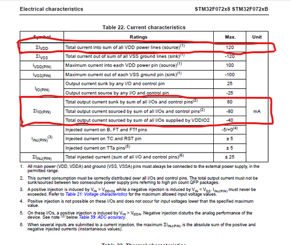

OK. Thank You for your reply. I have read this datasheet, in that there is a parameter mentioned II/O i.e. Output current sunk by any I/O and control pin that is 25mA. but I required total output current sunk by sum of all I/Os and control pins i.e. ΣII/O. what is the maximum amount of current can be sunk /source by all the GPIOs/ control pins at a single unit of time?

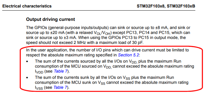

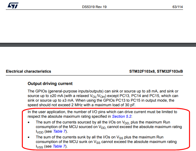

That was answered in the images posted by @STOne-32
2024-07-01 6:21 AM

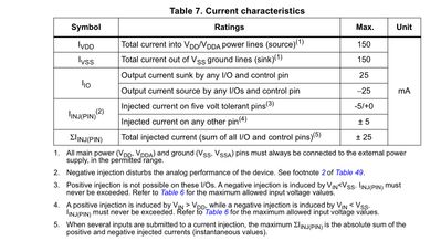

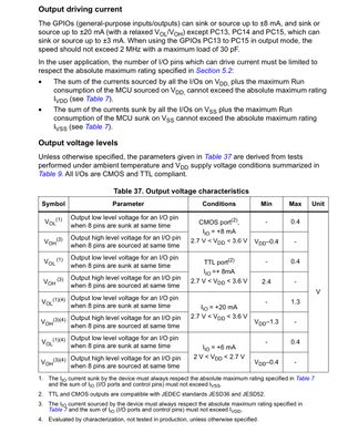

Above is the datasheet of STM32F072 controller. As mentioned in above image ΣIVDD and ΣIIO(PIN) are different. and for STM32F103 RBT6 only IVDD is mentioned i.e. 150 mA. So, I want to ask you that is ΣIVDD and ΣIIO(PIN) are same for the STM32f103? Because ΣIIO is not mentioned for STM32F103.
2024-07-01 6:30 AM - edited 2024-07-01 6:34 AM

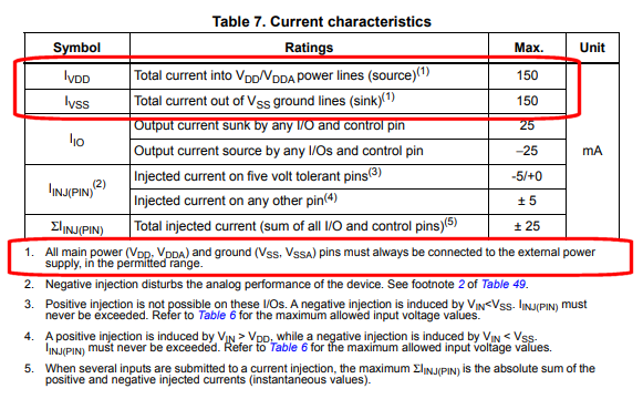

@stu1 wrote:I want to ask you that is ΣIVDD and ΣIIO(PIN) are same for the STM32f103? Because ΣIIO is not mentioned for STM32F103.
Not quite: as the notes above Table 7 for the F103 tell you, ΣIVDD includes the current consumed by the MCU itself.
ie, ΣIVDD = ΣIIO(PIN) + Imcu
You can work out ΣIIO(PIN) from there ...

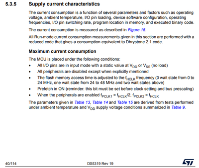

EDIT:
See the datasheet section 5.3.5, Supply current characteristics:
