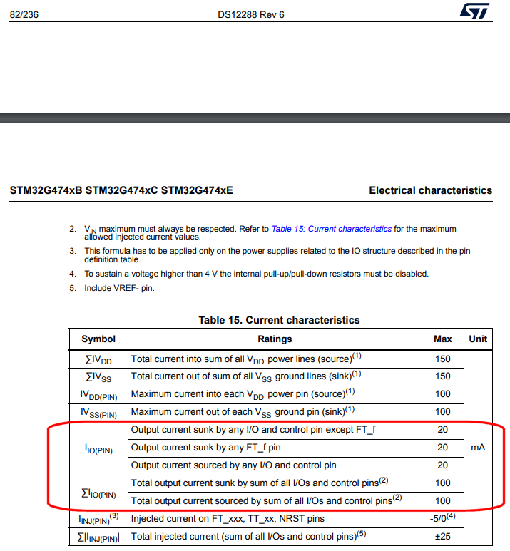

@hmcb wrote:This is above the capabilities of this Nucleo-64 board as it is stated that the maximum GPIO supplied current is 20mA per pin (100mA total across all pins).
Are you sure that's a Nucleo board specification ?
It sounds like a specification (limit) for the STM32G474RE chip ?
EDIT:
Here:
https://www.st.com/resource/en/datasheet/stm32g474re.pdf

Thank you for the speedy reply!
It looks like you're right, so I guess this means that no matter the supply, no more than 20mA can be supplied by or to the GPIO pins?
Meaning I need to use a transistor based solution to drive and switch the LEDs.
2024-07-01 7:46 AM
@hmcb wrote:this means that no matter the supply, no more than 20mA can be supplied by or to the GPIO pins?
Correct.
