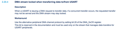

Thats why I was doubting the below errata sheet issue
I didn't clearly understand this errata sheet issue, could you please help me out.
