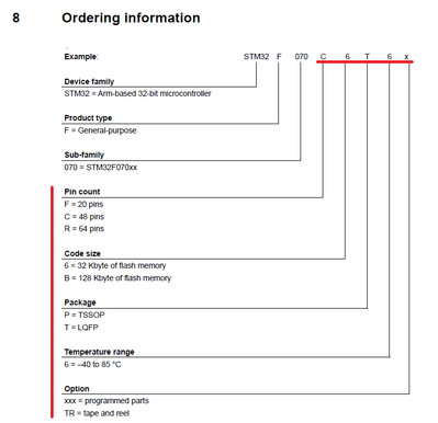

mƎALLEm
The information is provided in the datasheet: / section 8:  Ordering information:
