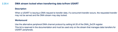

As per analysis, all the command's response was updated on global buffer. But for few commands, the response was sent through general sendStatus() and sendError() function (refer last functions in the earlier attached UART_DMA.txt file). Pointer to the global variable was passed to this function as an argument. Here, this function copies the data into its local variable and then further for transmission, pointer to this local variable is passed to task and its subsequent functions. Will check by making this variable as static.
But there is one more issue in addition to what all explained in this POST start description. The issue is in response to the command, STM sends response, but sometimes there is no response at all. Looks like Tx DMA got stucked. Only after STM restart, it recovers. I am doubting below errata sheet issue:
Can you explain how to recover from this issue using HAL functions.
