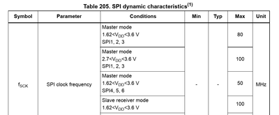

Hello. Is the STM32H753 able to directly interface with a slave on the SPI bus, which continuously produces data at a rate of 40 Mbps for several hours? What would be the current consumption rate for such a case?

the 40M speed is no problem, see ds :
100M max , slave or master.
Same as if not use SPI , almost. You can check it in Cube -> Tools ...power consumption.
