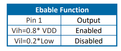

try : enable -> hi , connected to VDD.
Maybe the internal pullup is very high impedance, so even some moisture is enough to stop it working.
ds of other ECS-327 series shows :
So : better enable -> VDD .

What about the pin ENABLE of the TCXO?
It wants to see a clear high level to make the TCXO work.
Regards

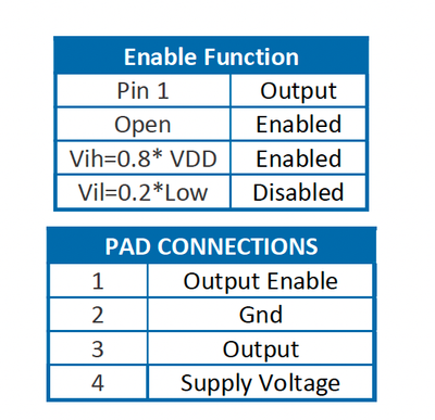

As per the TCXO data sheet, if the enable is left open it should be enabled.
2024-05-08 12:45 PM

Despite the fact that the datasheet says you can leave the enable pin open the problem was that is was left open. Tying it to VDD seems to have solved the problem.
