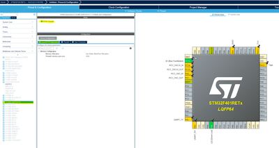

Hello @zoro and welcome to the community :),
Could you please precise which STM32CubeMx version are you using?
You can use X-CUBE-AZRTOS-F4 using STM32CubeMX 6.11.1 and Nucleo-F401RE as shown in the below figure.
