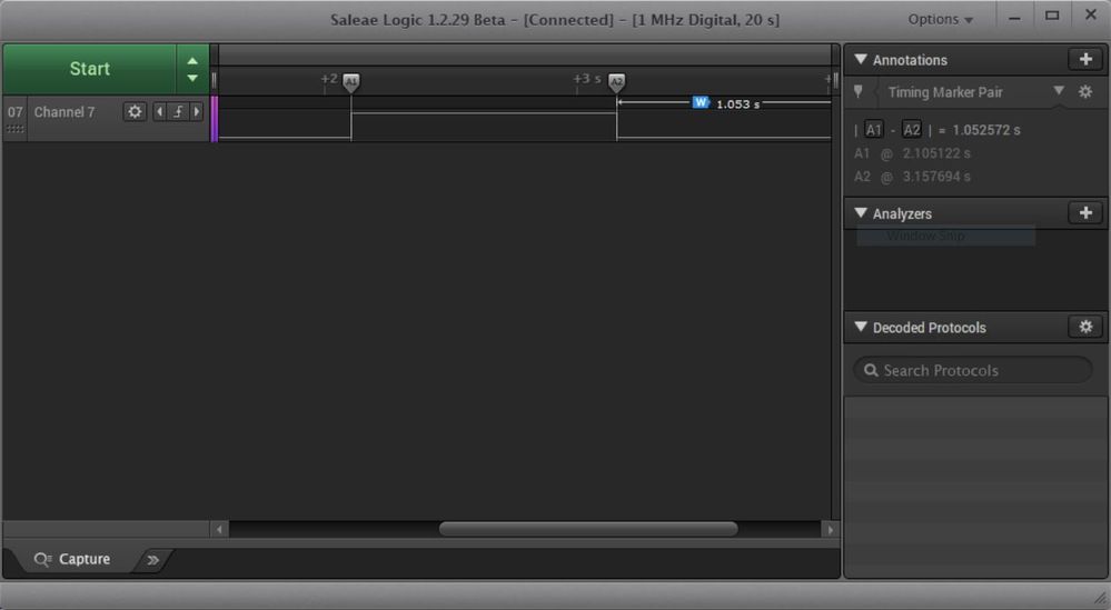

I had using STM32CubeIDE to generate ADC1 single channel with Timer 6 trigger on 1sec. In HAL library, everything work perfectly and I can see ADC interrupt happen exactly on 1sec interval. But when switch to LL library, same project but the interrupt happen slightly delay, like 1.052s. Just curious what's causing this? can anyone point me out. Thanks

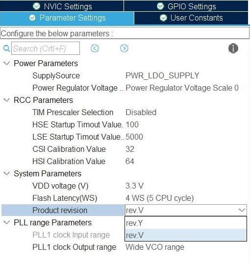

2021-08-04 7:34 PM
Thanks @TDK for point out the problem.
I found out that I had mistakenly set the product revision to Y instead of V.
Set it to V revision solve the issue.
