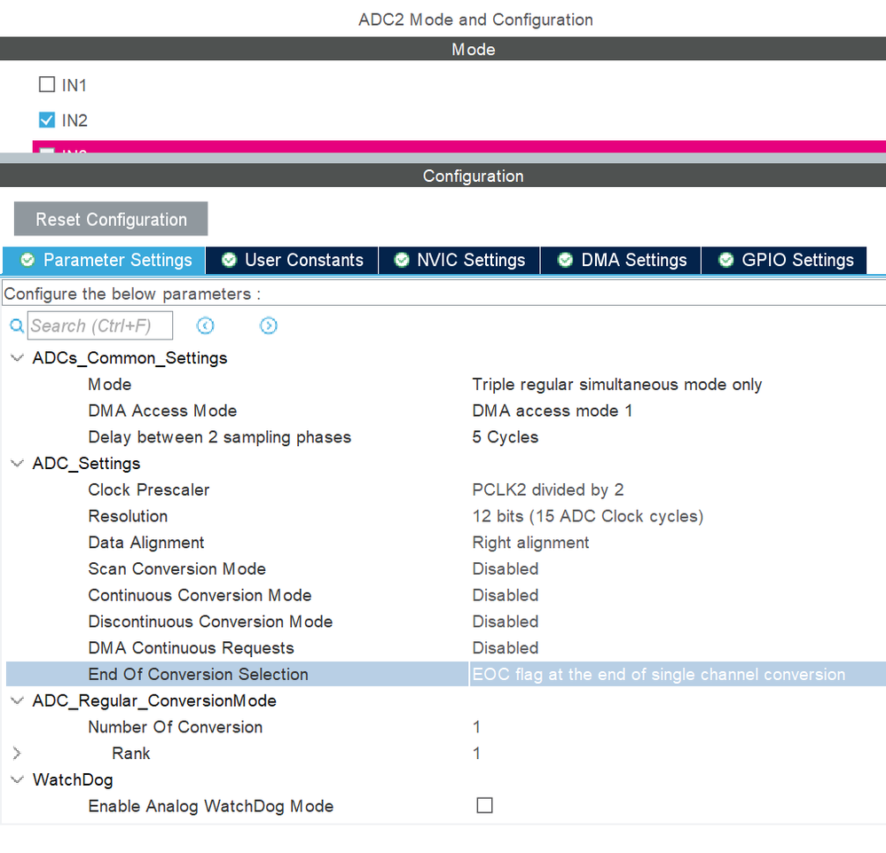

Hi, I'm having really a hard time setting up my ADCs to work with DMA using the STM32F429I-DISC1. My objective:
have a clock source from a Timer at a given frequency as trigger to the ADCs, each ADC would then read a specific pin (let's say ADC1-> pin_x; ADC2->pin_y and ADC3->pin_z). Since nothing is working regardless of the configuration I set, I'm trying with very big time intervals to avoid busy bus and so on. So I've set the TIMER8 to have a period of 5s and tested it individually with the interrupt enabled to make sure it is triggering and having the correct interval. Now the idea is to trigger the ADCs to perform a few conversions of the pins in order to do some oversampling.

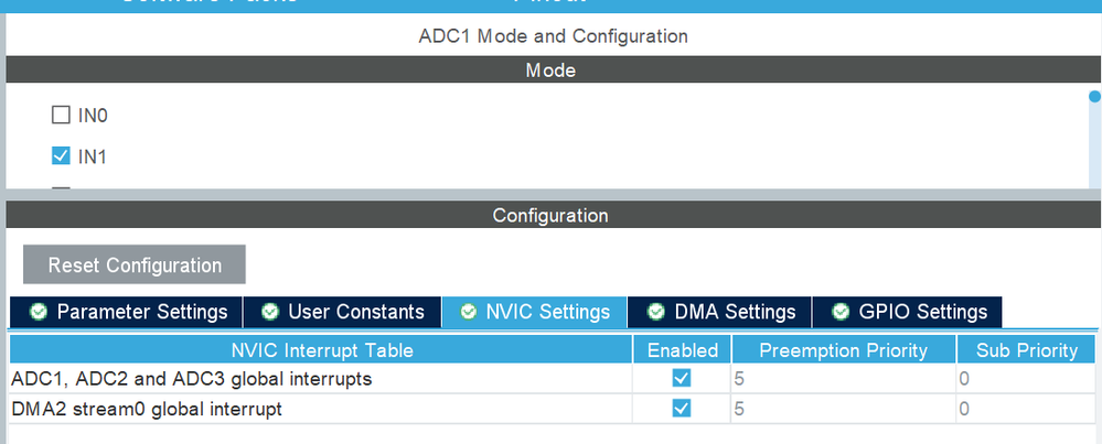

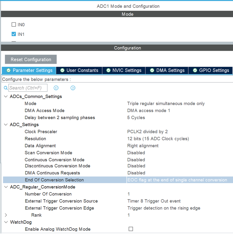

Here is my ADCs configurations:
The ADC3 is identical to ADC2. Timer8 Trigger Event Selection is set to "Update Event".

Problem is: it only fires HAL_ADC_ConvCpltCallback once at the beginning of the debugging and not anymore. My "test" variable is defined as "uint32_t test[3];".
I've already tried almost all combinations possible... tried changing EOC flag to "end of all conversions", tried circular and normal DMA modes, tried also some other ADC modes (continuous, injected, scan etc) but I only get one of the following results:
- either the callback keeps getting inifintely called blocking the rest of the application and leading to ADC overrun or;
- it triggers once and never more
Also pausing the debug session shows me that the results stored on the test variable are the ones from the beginning of the session, regardless if I change the voltage level ate the ADC pins. What am I missing here?

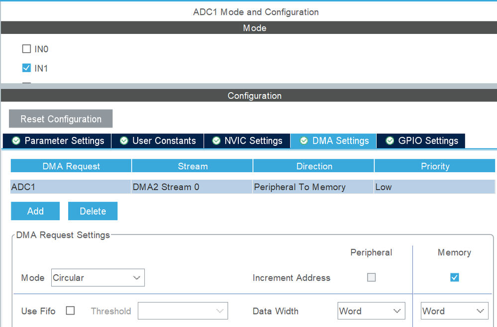

2025-10-27 5:19 PM
With circular mode enabled, you will need to slow down the rate of conversions so the CPU can keep up. Increase the sampling time and/or use a larger buffer for storage so the interrupts get called less often.
2025-10-27 5:26 PM
That was the initial problem, using DMA Continuous Requests as Enabled with Circular DMA, was causing it to infinitely trigger, regardless of the ADC conversion rate. Now that the ADC is triggered by a Timer with a very large period (multiple seconds), my expectation was that the ADCs perform the conversion very fast due to its ADC_CLK being very high, and that the DMA should transfer this result to the memory. If that would work, I could start thinking about increasing the sampling rate of the ADC but even with this current one, it is not working. Definitely not because the CPU is not keeping up, since we are talking about seconds. Or have I misunderstood your point?

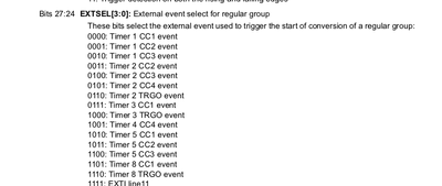

(I don't mean to hijack this thread - it seems similar enough to what I am trying to do that I'd like to amplify it, but not sure if that means making a new post about it).
I think the sticky bit here is that:
This all seems a little convoluted compared to how the triggering machinery works outside of the DMA context...so convoluted that I'm quite sure I am misunderstanding something.
2025-11-03 4:36 AM

> If DMA is in normal mode, it 'kicks off' once one ADC read is complete. The timer trigger does not 'restart' it, and (to my knowledge) there's no "access point" for restarting the DMA automatically at the timer trigger point.
Which is not the way things work, as I understand it.
You would need to trigger the ADC to get this chain going, not DMA.

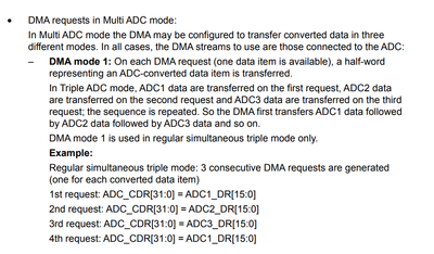

Assuming the F429 is not too dissimiliar from the F407, here a snapshot from the reference manual of the latter:
I have always used DMA in circular mode for this purpose, although with a larger number of transfers at once.
This should work as well in dual and triple mode.
IMHO dual and triple modes only make sense if you need a set of ADC channel data in shorter intervals than possible by one ADC alone. I never used it.

The whole topic is for me too confusing for multiple reasons.
Some parts of the documentation seems to say that DMA in Circular mode is used when you do not want to set up the DMA every time manually after each triggered conversion, which was exactly my initial purpose. Also, this is different than having the ADC mode with "Continuous Mode: Enabled", which would trigger infinitely conversions after the last one is done (which is NOT what I want). So it seemed clear that Continuous Mode: Disabled with DMA Mode: Circular is exactly what I need. But it seems this circular mode keeps generating requests even if no new conversion is done
Setting the the DMA Mode to Normal, on the other hand, would seem to solve the problem as long as I keep activating the DMA manually after every trigger. I did try this option as well but it did not work, it only triggered once. Here I must admit, perhaps I've activated the DMA in a wrong way after the trigger or forgot to clear/set important flags, not sure.
In the end, responding to your question @sb_st , no I did not find a solution so I just gave up this freaking DMA usage for this case. I found the whole documentation quite poor on covering the multiple mode of the ADCs. Also following the steps presented on document UM1725 did not help at all. Now I am running on Multimode with interrupt only, reading manually the values from the ADCs, which was also kind of cumbersom. The documentation of the ADC Extended driver seems to be the one with all MultiMode HAL functions, but guess what? No "HAL_ADCEx_MultiModeStart_IT()" exists, even though it seems possible to use Multimode with DMA Disabled.
At the User Manual itself if you go to ADC->Multimode ADC->Regular Simultaneous Mode->Triple mode sub-chapter, it is explicitely only mentioning DMA procedure, as if it would not be possible to use it without DMA.

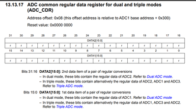

Furthermore, at the ADC_CDR register explanation:
it seems the upper 2 bytes holds one conversion value whereas the lower 2 bytes, another converted value, on Multimode, alternating. But on the Multimode Chapter itself:
it leads me to believe the ADC_CDR is completely overwritten by a single result every time. Perhaps I just did not get anything about the whole concept of this ADC but as for now, the documentation is just ***. So I've set up manually the registers to work in a kind of Multimode Simultaneous Regular conversions with interrupt at the end and that's it.
2025-11-03 10:17 PM
> ... it leads me to believe the ADC_CDR is completely overwritten by a single result every time.
Yes, it is.
Which is exactly the same behavior as with ADC_DR and multi-channel conversion sequences.
You need to pick up the result immediately, or it will be overwritten.
ST has the ADC designed this way, and assumes you use DMA for more complex and time-consuming setups.
