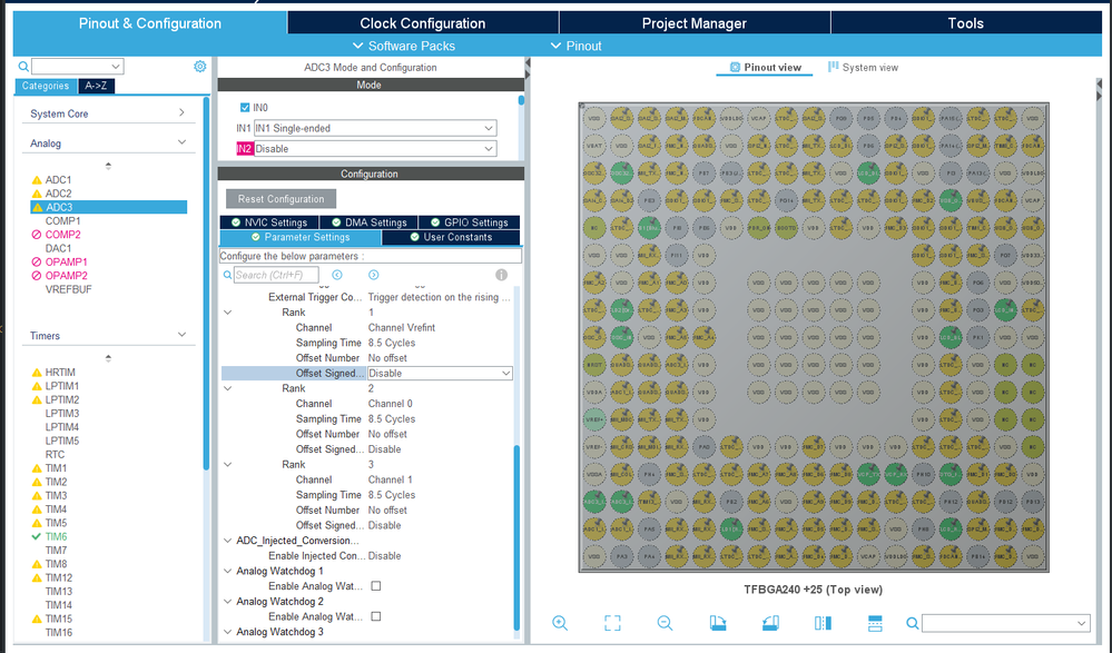

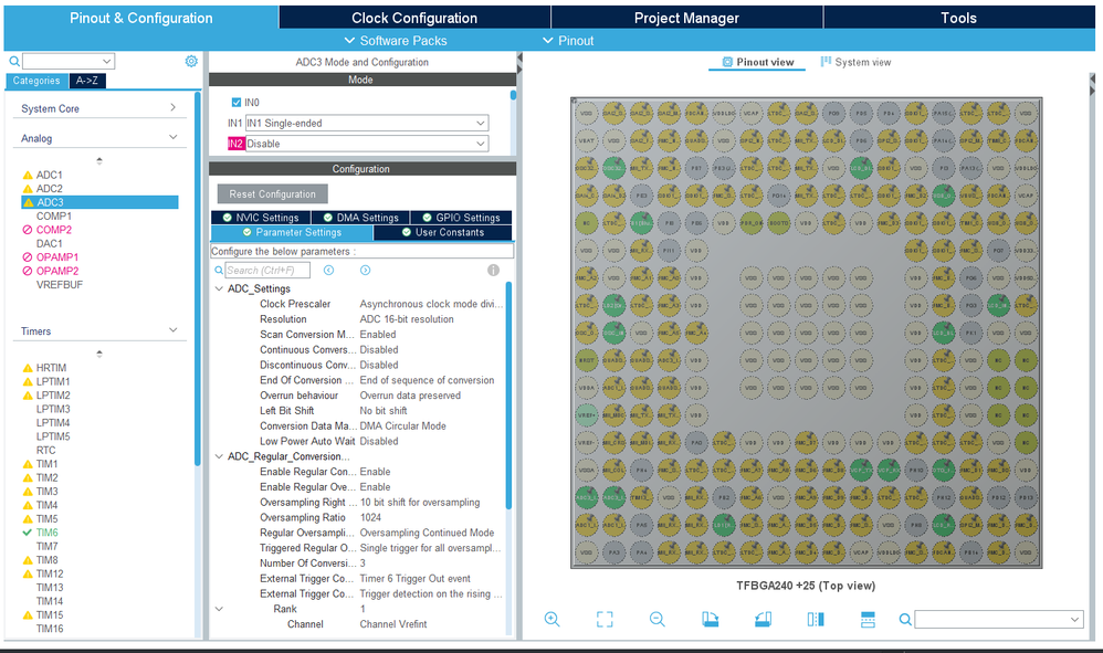

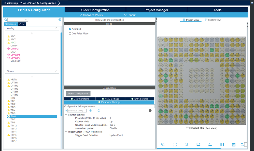

I am using ADC with configuration like this
and I am triggering my ADC with 1ms TIM6 and sending this to PC where I display it

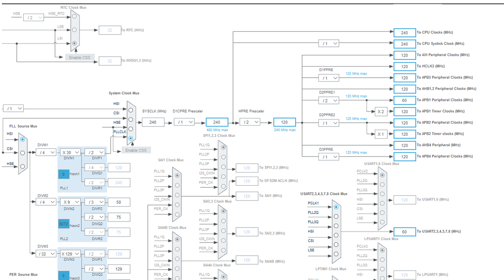

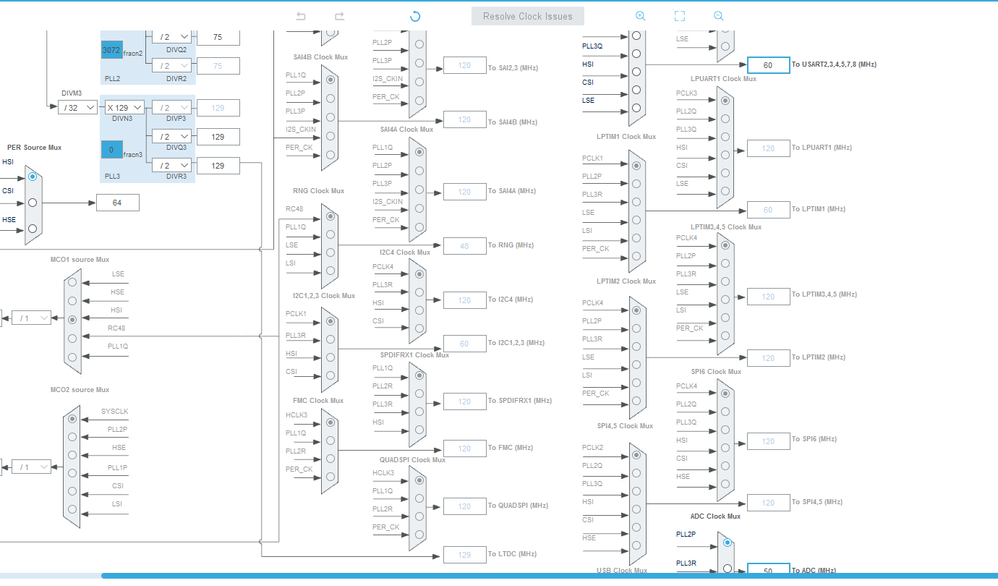

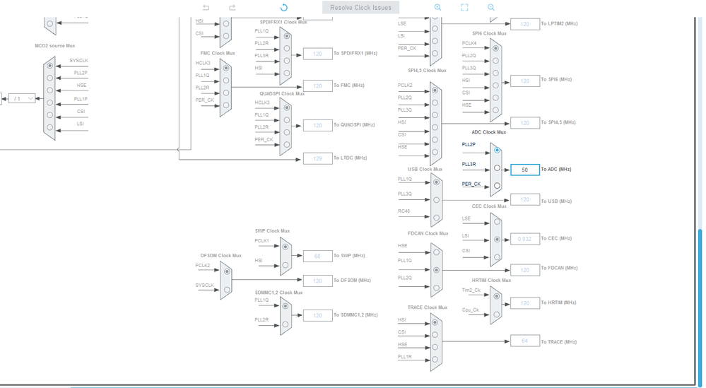

I am using 240Mhz CPU Clock and my clock configuration looks like this

Hi there, I am triggering single conversion every 1ms (picture should show that so I believe single conversion every 1ms) (I have 3 channels if it helps any)

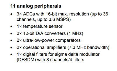

https://www.st.com/resource/en/datasheet/stm32h750ib.pdf
Please find the datasheet of the MCU as per attachement.
If you really need performance: Use DMA with double buffers, trigger ADC with a timer and things will go much faster. You can also use USB or ETHERNET to send data to your PC in bursts, this will also increase performance. If you want to know where your bottleneck is, do the math and use the datasheets...

I am triggering ADC with TIM6 already (TIM6 counts with 1ms (at least I think it is (was always confused on how to calculate its tick, so I just set PSC to 0 to make it easier for myself)) like pictures shows

I do not understand your statement "At first would just like to find the sample rate"; when you trigger ADC with 1 ms, then the sample rate is 1KHz?
2023-09-09 3:40 AM
Oh, ok, so if I trigger my timer with 1ms, my sample rate will always be 1kHz, regardless of ADC clock, its sampling time per channel (8.5 Cycles), its prescaler?
