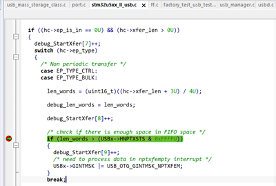

My code hits below statement in the code, here "hc->xfer_len" is 512 bytes and this makes len_words = 128.
The highlighted if statement gets true and due to that NPTXFEM, interrupt is getting enabled.
As soon as the interrupt is enabled we are continuesly getting NPTXFEM interrupt and code gets hang in HAL_HCD_IRQHandler(),
In stm32u5xx_hal_hcd.c file this interrupt is not handled.

The snippet that you're quoting is here in function USB_HC_StartXfer() , correct?

1. Yes, correct the snippet is from USB_HC_StartXfer().

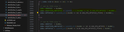

Also As per data sheet of STM32U575 max size for DIEPTXF0_HNPTXFSIZ (Non periodic transmit FIFO) is 512 bytes, but HAL library allocates only for 128 bytes in USB_HostInit().
