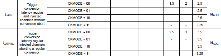

When the ADC is triggered by a timer there is an extra latency before ADC will start conversions.
This latency is defined in the STM32H7 datasheet (Table of ADC characteristics) and this could explain the behaviour that you see.
If you are using Dual interleaved mode, the master will start conversions only after slave finished. So, this will impact the sampling rate.
By the way the dual interleaved is for max perf and is used in continuous mode.
I would suggest that you add more details to your post, specifically about your use case.
