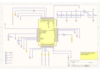

This is my schematic that I will use on my board (The stm32 part of the board, the other parts of the board design is not finished yet)

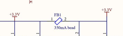

1) The board is supplied by a converted 3.3V from 3.7V battery. I am not sure about the affect and placement of the ferrite bead when using a single 3.3V.

2025-07-17 9:18 AM
A ferrite bead connected to the same net on both sides doesn't do anything.
Schematic otherwise looks okay.
You don't need HSE or LSE for low-power modes.

2025-07-17 9:05 AM
Have you studied Application note AN4555, Getting started with STM32L4 Series and STM32L4+ Series hardware development ?
With so many spare pins, make some testpoints for debug purposes; provide access to a UART.

I realized that if I power it from the same source it wont help but I am not sure what else to do.
Would removing the bead and giving the same 3.3V affet ADC too much.
Or should I divide 3.3V into to lines, use a unity gain buffer and then give it to VDDA maybe?
I thought of using a standard header but I want to minimize the board area. Also, why debugging pins have 3.3V if debuggers cannot power while programming. Should I remove 3.3V debugger pin and continue to power from battery when flashing?

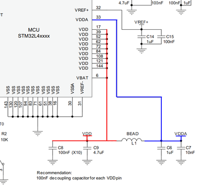

2025-07-17 10:01 AM - edited 2025-07-17 10:07 AM
@Stm325 wrote:I accidentaly accepted this as answer
Instructions to un-mark it here.
@Stm325 wrote:I realized that if I power it from the same source it wont help but I am not sure what else to do.
That is shown in the App Note:
So the bead separates VDDA from VDD - it forms a filter between the two.
This is pretty standard - not specific to STM32
As well as the schematic, you should also pay attention to layout.
EDIT: added colour
@Stm325 wrote:Would removing the bead and giving the same 3.3V affet ADC too much
Depends on how precise you your ADC measurements need to be - only you can say what is "too much" in your particular application
2025-07-17 10:12 AM
I would use the same net for VDD and VDDA. No ferrite bead.
The ferrite bead will slightly help analog performance, but only if there is sufficient EMC in the frequency range attenuated by the bead. It will not make a huge difference. Read about improving ADC accuracy here:
How to optimize the ADC accuracy in the STM32 MCUs - Application note
The 3V3 pins on the official debuggers are to let the debugger know the voltage on the board. They are inputs to the debugger, not outputs.
Typically, yes, power the board using normal means (in this case, a battery), and connect the programmer to flash.

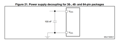

I will update my schematics accordingly. I am just confused about one more thing from the application notes:
In the application note it is mentioned to use a 1nF and a 1uF capacitors. VDDA/VREF+ pins are the same pin in my schematic.
But in ADC optimization it is mentioned to use a single 100nF capacitor for power supply decoupling.
Which one should I follow or are they for different purposes. Also I am thinking of grounding the pins around the ADC pin so that they are always 0 and do not cause any interference
2025-07-22 12:44 PM
You should use both the 1 uF and the 100 nF. My guess is this is an oversight in the app note as the text explicitly says to use both. There is no technical basis for why a 1 uF would not be needed when the pins are combined, but needed when they are separate.
