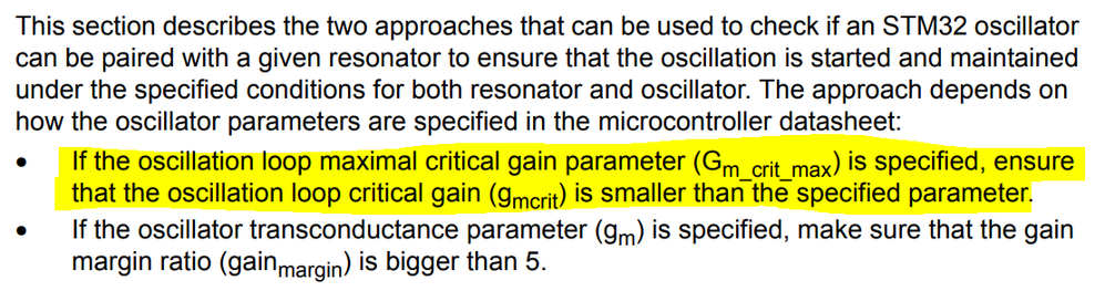

> Again, my specific question here is whether or not 1.5mA/V is the correct value to use for Gm in the calculation.
It's not.
> but using the Gm value of 1.5mA/V
The value from the datasheet is g_m_crit_max, not g_m:
AN2867 says how to calculate g_m_crit for your crystal:
For the one you mentioned, I calculate this as 0.142 mA/V.
AN2867 also states the requirement is based on how the crystal is specified. (But note that the two requirements are equivalent, as g_m_crit_max = g_m / 5)
Since g_m_crit = 0.142 mA/V, this is way less than g_m_crit_max = 1.5 mA/V, so you're good.
At least that's how I read it.
2020-08-31 3:54 PM
Ah. I missed that distinction in the app note. Makes perfect sense. This would also explain why my current crystal is not working, since it calculates to a g_m_crit = 1.98, which is above the specified g_m_crit_max. Thanks so much!
