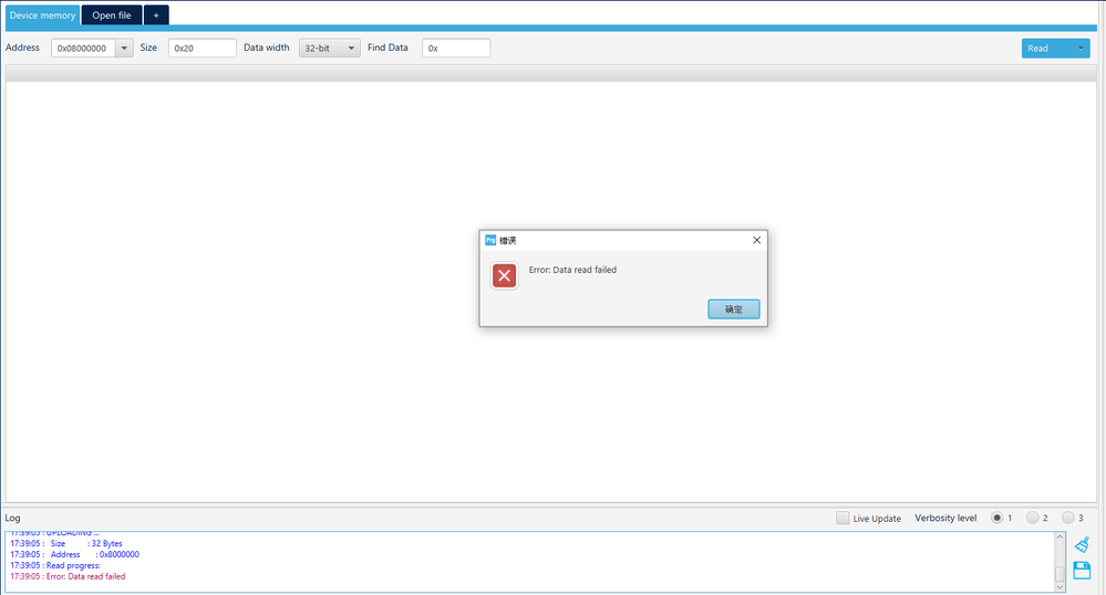

(3)Erasing full chip via the SWD interface using J-flash(J-flash->Target->Manual Programming->Erase Chip), and the MCU is back to normal.
Note: As there are 2 boards with the same problem, one has recovered to normal, while the other remains in the error state.
Given that the read protection is set to level 0 , I am puzzled as to why flash bank1 cannot be read.
Has anyone encountered a similar problem before? Any suggestions or advice would be greatly appreciated.

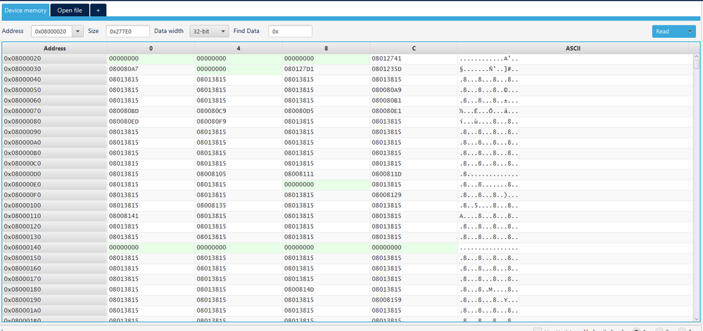

2025-01-18 3:31 PM
Programming the same 32-bytes "flash word" twice can cause the ECC error. Don't do this. Program the flash by whole 32-byte units, aligned on 32 bytes. Write each unit only once. Even if the data is all 0xFFs do not write it more than once.

I got a ST-LINK. Reading option byte ok, checking RDP =0xAA means there are no read protection. But reading flash still failed. Log:

15:46:53:671 : UPLOADING ...
15:46:53:671 : Size : 256 Bytes
15:46:53:671 : Address : 0x8000000
15:46:53:671 : Read progress:
15:46:53:672 : Reading data...
15:46:53:672 : r ap 0 @0x08000000 0x00000100 bytes Data 0x20036450
15:46:53:672 : Error: Data read failed
15:46:53:733 : r ap 0 @0x1FF1E7FE 0x00000004 bytes Data 0x003FFF91
Best Regards!
ADD:
The first 32 bytes of the MCU's flash bank cannot be read, but the subsequent parts can be
0x08000000-0x0800001F read fail
0x08000020-0x0801FFFF read ok
