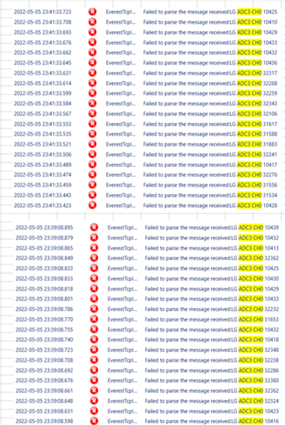

I'm having some ADC+DMA sampling problems with the H750.
When the ADC+DMA is working, in continuous mode, PC2_C(ADC3_CH0) gets 16bit sampling data which is unstable and constantly jumps between 10000+ and 30000+. I guess there is a problem with the code configuration.

The following is the sample data of PC2_C

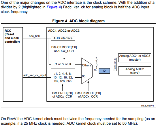

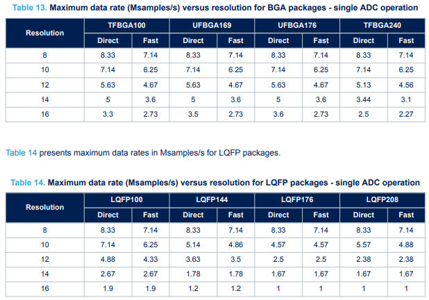

2022-05-13 7:31 AM
Are you sure about 10Mhz sampling frequency?
Check DM00609692 and dm00628458:
in Cube IDE configurator: SystemCore → RCC → Product Revision → rev.Y / rev.V
(must provide 2x frequency revision V compared to revision Y).

2022-05-16 2:50 AM
Sorry, 10Mhz sampling frequency is my mistake, 10Mhz should be Fadc_ker_ck. The configuration of Rev V and Rev Y in RCC is something I didn't pay attention to before, and I also chose the wrong Rev. Thank you for reminding me. I will do some tests to see if this change solves my problem.
