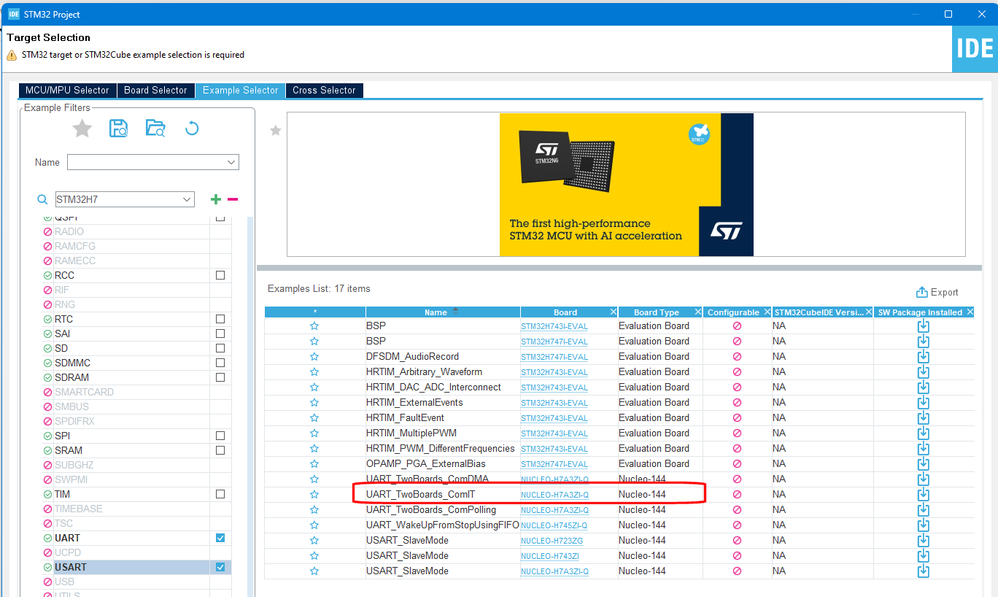

2025-01-28 9:20 AM
@Andrew Neil wrote:The examples in CubeIDE/CubeMX would illustrate that.
Apparently not for that exact board:
