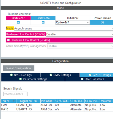

2025-01-28 6:11 AM
@Andrew Neil, @Louie88
I checked with latest CUBEMX 6.13.0, starting a brand new project from "Acces to BAORD Selector", then picked up the
Then, i choose to initialize all peripherals to their default configs.
And I could check that PA9/PA10, are properly assigned to USART1 TX/RX.
So no issue in CubeMX from my point of view.

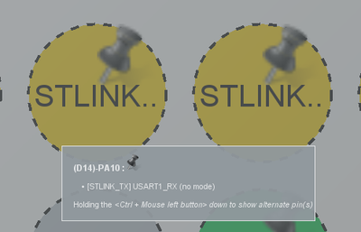

2025-01-28 6:37 AM
Indeed.
I just tried creating a project for the STM32H747I-DISCO board, and CubeMX clearly identifies the pins connected to the ST-Link VCP:
