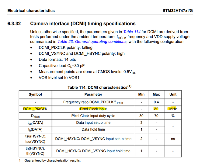

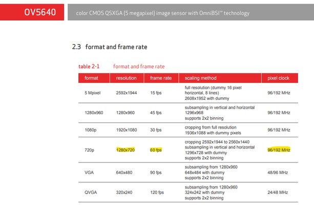

To achieve the target resolution and the frame rate, you need to refer to the OV5640 datasheet, and STM32H747 datasheet and check all constraints.
As mentioned in the OV5640 datasheet, to reach 1280x720 resolution and 60 fps frame rate, you need to configure the pixel clock at 96 MHz.
But when we refer to the STM32H747 datasheet, we see that the maximum pixel clock is 80 MHz.
To reach higher frame rates, I recommend you to decrease the image resolution to ensure the maximum pixel rate constraints.
Thank you.

2025-06-24 2:16 AM - edited 2025-06-24 2:17 AM
Hello @KHowe;
Thank you for updating the post and providing more details about the target.
Thank you.
Kaouthar
