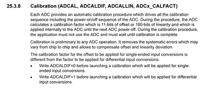

As i understood, HAL_ADCEx_Calibration_Start() should be called every "startup". Is there a way to call it self-calibration of the ADC once, save the calibration values (e.g. to internal eeprom) and every statup to recall the same self-calibration values?
I found and used:

2024-07-30 7:09 AM
In addition to the linearity factors, you'll need to program the offset as well, which can be found in the ADC_CALFACT register. The reference manual goes into detail on this, including how to read/write values.
