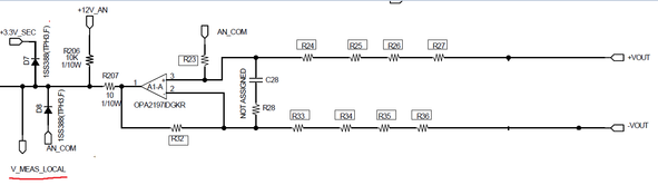

The spec of our power supply allows a maximum of 0.05% error. The issue is that some of the voltages give accurate reading and some(as the 6V mentioned) give and error which varies depending on the output voltage. Unfortunately I cannot share the entire schematics but i can show the resistor divider network.
The V_MEAS_LOCAL is at value of 0-2.7V.
I should mention that When measuring the value of the input to pin PA6 of the MCU (this pin is ADC12_INP3) the voltage is fairly accurate and is what expected. It seems the problem is with the values the ADC1 outputs.

Oo , whats the pullup to +12V intended for ??
2024-07-18 12:28 AM
it defines a small offset in the voltage level
