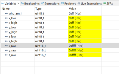

After debugging, values are obtaining as follows:

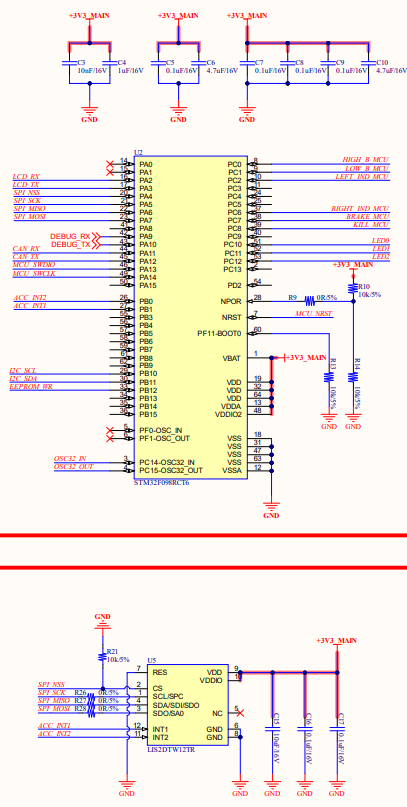

Here is the schematic:
The who_am_i register is not return the correct value(0x44). Instead it return 0xff.

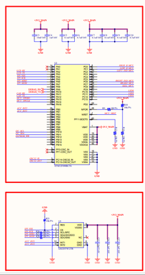

Here is the schematics :

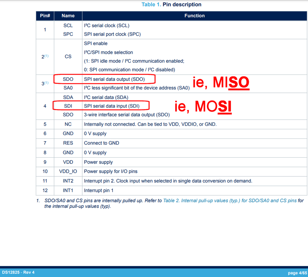

Are you sure you have MISO and MOSI the right way around?
:thinking_face:

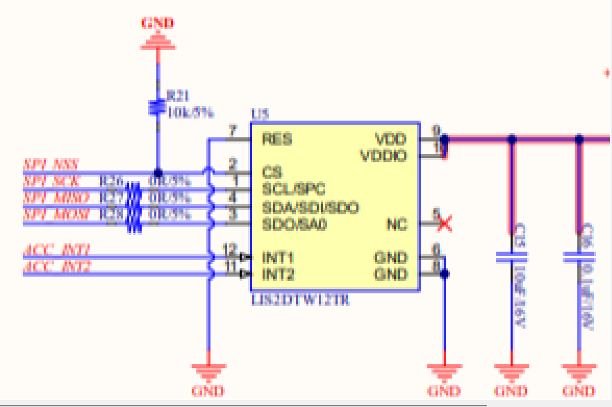

Andrew Neil
Super User
Your schematic is still pretty low-res:

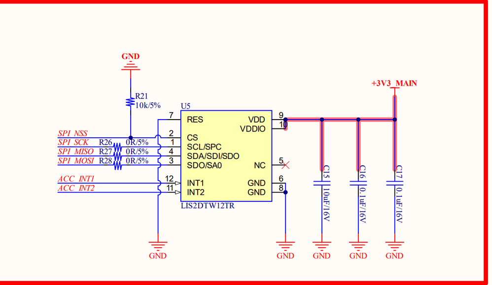

Hi Andrew,
Sorry for the low picture resolution. Here is the new one, please check it. Screenshot 2024-07-30 093828.png
