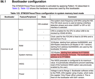

Hardware status: BOOT0 HIGH works perfectly, I can access the system bootloader over USART1 (PA9/PA10), and program via UART. Hardware is validated and all connections are good. PB15/PB14 pins are floating, not connected anywhere.
My need:

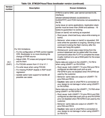

Reference Manual Table 123 and Table 124 (bootloader address 0x1FF00000, entry 0x1FF09800, V9.1 limitations).
Datasheet: "Jump issue" and "boot mode is only checked at reset."
