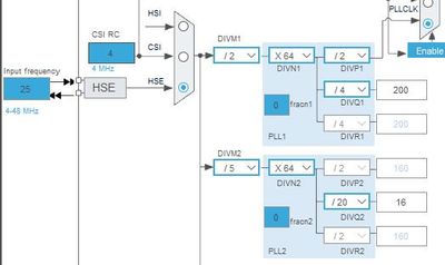

2025-09-19 3:30 AM
I tested using the HSE with an external crystal (Ref. below image), but the issue still persists.
2025-09-19 3:37 AM
Even if the issue still persist, please keep that configuration.
To avoid unnecessary ping pongs, better to share your project so we can help you efficiently.
