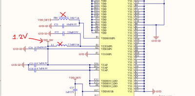

As per the Input, I have remove the FB1, L1 to keep the SMPS OFF and apply 1.2V to VDD_SDC at the core voltage and it take 11mA current in core and 64mA in 3.3V. After then I am able to programmed the board and execute the code.
Then I have insert the L1 and apply short link instead of FB1, in this condition the board is also working properly. On Saturday, full day that board is working properly.
On Monday, when I power up the board, it takes 1.5A current so I immediately turn off the board and do the same changes as I do to give 1.2V, core voltage directly. Now, it takes the same current, 11mA for core. But the issue is that after programming the board, the programmed is not execute and I have simple toggle the GPIO and keep LED on it. I can detect the MCU, programmed it successfully but the LED is not blinking.

so with correct core voltage (about 1.2V ) board ia running. ok.
But i dont understand:
Programmed ok, but not running at all - or what? Maybe start-problem, reset on core might need power down here for reset - or is this the "1.5A unlucky cpu" -- then maybe very sick cpu...
