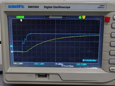

2024-07-29 4:54 AM
Boot0 is kept GND through 10K.
Now we have done the task as mentioned below,
Please provide the suggestion on it.
Regards,
Alpesh
2024-07-29 6:23 AM
So everything seems ok, when CPU runs and LEDs blinking.
But same CPU can be starting -- wrong.
Just this is a last test: there is the core supply with the 2 uF caps, Vcap. Try just soldering a 470 ohm SMD resistor on one cap, in parallel ( on top, is easy).
Then check starting behaviour again, with the simple test program.
Btw. I found, on some CPU the core voltage not going down fully, then the core gets no correct reset on external reset and behaves silly.
The additional resistor discharge the core voltage and helping the core correctly resets.
So you should check startup after short or longer time without power - might show different behaviour.
If this not giving good behaviour, replace the CPU.
