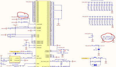

I have made further detail testing and found that when I mount the FB1, FB12 and R1, the current goes up to 500mA and heat the MCU. These are the components for the internal DCDC to make turn on. Find the image for your reference.
So, what it should be the issue?
Regards,
Alpesh

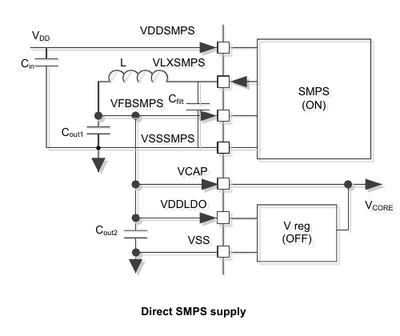

See reference figure in datasheet:
@ABora.4 I updated this reply. My original reply had some issues.

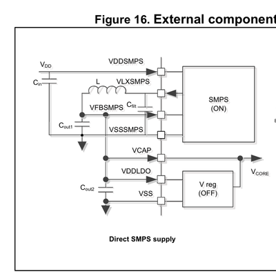

i think he using direct smps connection, VCAP connected to vfbsmps :
But i wouldnt do this - seems to dangerous to me. If anything wrong with smps hardware or setting - kill cpu.
2024-08-02 6:43 AM
The separate gnd , connected just by R1 , is bad idea. There should be one full ground plane.
Or dont use the smps, but the LDO , if so much fear to get EMI from smps :

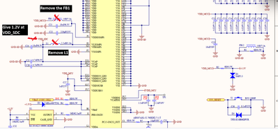

Thanks for the suggestion.
As this is a BGA package so I cannot make difficult changes but I can do as mentioned below,
1) Remove the FB1 to stop the internal SMPS.
2) Remove the L1 to isolate the SMPS output to LDO/VCORE input.
3) Give 1.2V externally to the VDD_CORE which is going to the LDO/VCORE.
Below is the reference image.
Kindly check and provide your Input.
Regards,
Alpesh
