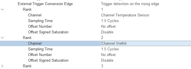

My Cube settings for G491
and for H745
2023-01-09 10:49 AM
1.5/2.5 cycles sampling time is certainly incorrect. Read datasheet.

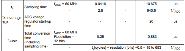

This definitely seems to be the cause. Definite disconnect on my end about how it works. Still something isn't clear though. The datasheet excerpt is this:
My ADC is clocked at 120Mhz, however I am sing a prescaler of 2, so it is effectively 60Mhz.
This seems to imply I can select 12.5 cycles?
I noticed with 12.5 cycles this is still not accurate. But as I increase cycles the accuracy increases. For instance, at 12.5 cycles my ADC reading is still ~500 which ends up being -110C.
If I increase the cycles to 92.5 then my temperature is 44C. Closer, and possible.
If I increase the cycles to 247.5 then my temperature calculates to 29C. This is probably correct.
So, I guess I am trying to get a little further understanding of this.
Based on what I've read, Tconv would be (247.5+12.5)/60M
About 4us. So, with this in mind, I am converting 230769 times per second.
Is that the right thinking? The sampling is adequate.
Thanks for pointing me in the right direction.
2023-01-09 12:54 PM
Refer to Temperature sensor characteristics in datasheet, should have something like:
ADC sampling time when reading the temperature: 9 μs
