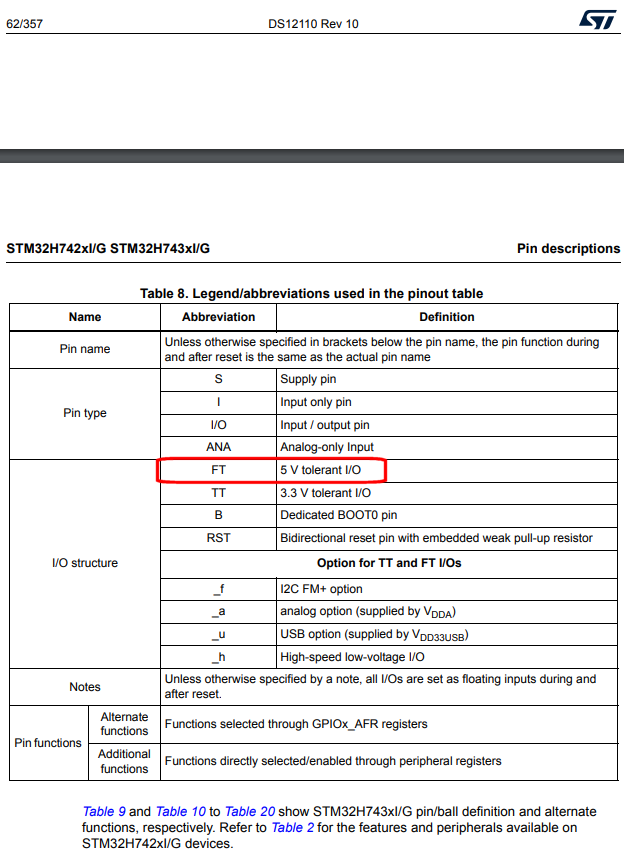

@sktech You do not need a level shifter if you connect the encoder to 5V tolerant GPIO (labelled FT). See also this thread, for example or RM0433, section 11.3, fig. 71.

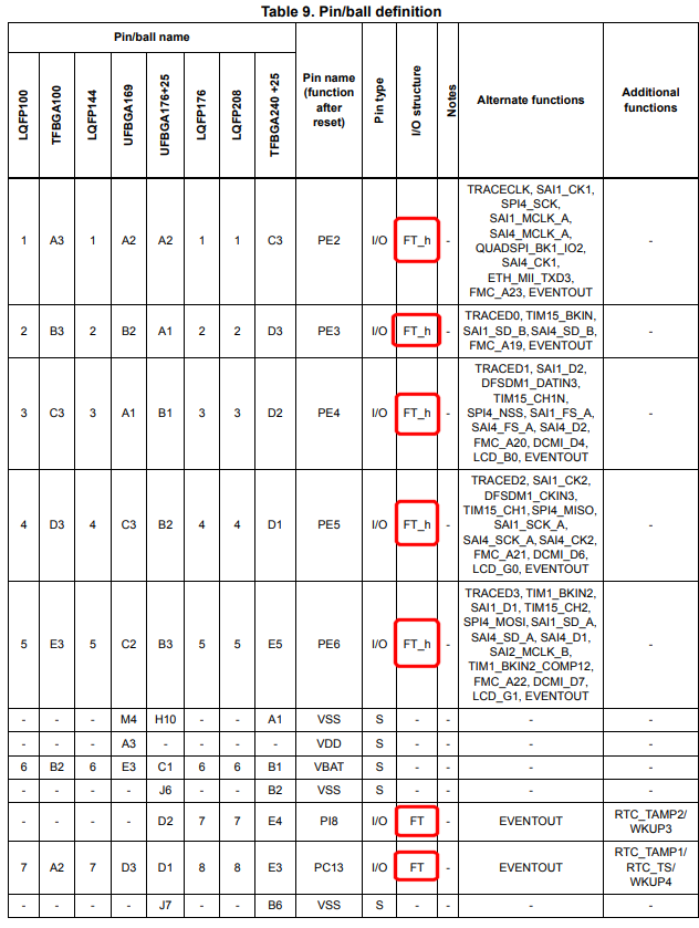

It is easy to find out which pins are 5V tolerant: find out the pins to which you want to connect the encoder, then find the corresponding connection structure in the data sheet, table 9 in column I/O structure (possible suffixes are explained in table 8).

@sktech wrote:I don't know which pins are 5V tolerant,
It's easy to find out:
https://www.st.com/resource/en/datasheet/stm32h743vi.pdf#page=63
