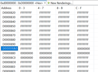

I wrote a test that uses the DMA2D to transfer 64kB of data from AXI SRAM to an external SDRAM. I set the source data to be all 0xFF and started the DMA. Using the Memory viewer in STM32CubeIDE I see that the SDRAM is getting filled, but there are random gaps filled with 0. There is no pattern to the gap spacing. Example gap shown here. The zeros were written because there were F's at those addresses previously.

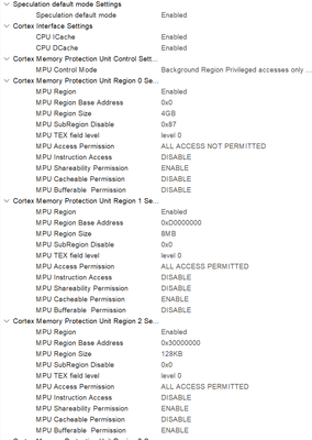

The MPU is enabled and set as follows:

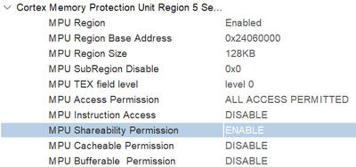

As an experiment, I added a section of AXI SRAM to the MPU config, set it to full access and placed my source buffer at that address. The transfer happened correctly. There were no gaps.
What is happening here? Note that using the MDMA gives the same results. Also the gaps appear in different places from run to run.

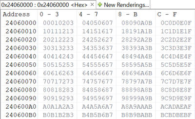

Consider populating memory with more interesting/traceable data. Such as 0x0001 0x0002 0x0003, ... . Then, if it still gets mixed up, you have more of an idea where and how it happened. And if gaps occur, you can determine if bytes were dropped, skipped, inserted, or corrupted.

Thanks for responding. Valid point. I did see a difference between the compare fails vs. what was on the Memory viewer. There are addresses that don't fail, but show up as 0 instead of the written value in the Memory viewer. However there are still gaps that fail (read 0) which also show up as 0 in the Memory viewer. I used an incrementing data pattern as TDK suggested. A fail log snippet is shown below (the address reported is the offset into 0xD0000000, the SDRAM space).

When I create a section of the AXI SRAM that has ALL ACCESS in the MPU config and place the src buffer at that address, the fails go away.
I'm trying to understand why this works.
